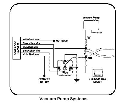

I am wondering how to wire everything for keyless entry with a vacuum system with my alarm. It seems to have a built in relay for it or something.  The keyless entry harness is as follows:
This is for an Ungo 2004 alarm
5-Pin Door Lock Harness (See Door Lock Diagrams - Page 14)
Pin 1 - WHITE/ Black: Lock 87A (Normally closed)
Pin 2 - GREEN/ Black: Lock 30 (Common)
Pin 3 - Blue/Black: Unlock 30 (Common)
Pin 4 - BROWN / Black: Unlock 87A (Normally closed)
Pin 5 - Violet/Black: Lock/Unlock 87 (Normally open) [10A Fuse]
The alarm installation manual has this diagram for how to wire the keless entry:
1989 VW Jetta -- posted image.
I have it all wired up as the installation manual says but it just doesnt work.  I used to have this alarm in a newer jetta wired this way and it worked.  A couple resistors blew up in the drivers door before it worked but after the resistors blew up everything worked fine and dandy..  I cant seem to get it to work in my 1989 jetta with vacuum system.  It seems to sometimes, not all of the time, unlock the doors but it unlocks them and then locks them and does this twice.  In the end the doors are still locked.  I cannot get it to lock the door when arming the alarm.
Is tehre another way to do this?  I was thinking of making the two relay thing as the site says butdont know how ti integrate that with my alarm. I would think i dont need to do that as my alarm has a relay build into it.
Any ideas would be great.

anyone?  Theres a couple questions there.
Answers to the bottom one would help the most Thanks

Im still messed up on the keyless entry.  any help?
