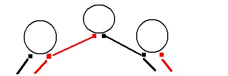

I have recently installed a complete system in a 2002 Trailblazer. The system consists of an Alpine 9815 head unit, Phoenix Gold x200.4 4 channel amp (200 watts/channel), Diamond Audio D661S components up front, and a pair of Infinity Kappa Perfect 10s. For the front components, the 6.5s are mounted in the doors and the tweeters are mounted in the dash facing the windshield. The reason the tweeters are not mounted in the door is due to the very low available speaker locations and I do not want to cut holes in the doors panels. I am very pleased with the sound and accuracy, except for the front image.
I am considering installing a single tweeter (older MB Quart I've had lying around) as a center channel in the dash or on the back of the rearview mirror. I was planning to run this speaker off the outputs of both of the front tweeters. In other words, use left speaker + and right speaker -. Of course the Diamond component set is 4 ohms and I am running them stereo from the amp. The Quart is 6 ohms. The question I have is what load would the amplifier "see" with the above wiring configuration for the front speakers? What negative or positive effects should I expect from this setup?
Thanks in advance
Shaun

Negative is the key word.
This is a wiring configuration you will not see in any wiring diagrams.
Briding center channel speaker -- posted image.
Each tweeter is getting an AC signal;  it alternates from neg to pos to neg to pos etc.  This is true of any speaker in an audio system.  When you look at the wiring as displayed here, you see that the left tweeter neg meets a 4 ohm load, and that the right tweeter pos meets a 4 ohm load.  What do the other two wires meet?
Right, a 4 ohm driver and 6 ohm driver that are parallel-connected, which is a 2.4 ohm load.  https://www.the12volt.com/caraudio/boxcalcs.asp
How do you suppose that's going to sound like?  For basics, the crossover is designed to match the given tweeter to the mid, and it's also designed to separate frequencies according to a given impedance.  That impedance is designed for 4 ohms.  Look at https://www.the12volt.com/caraudio/cross.asp, specifically at high pass crossovers and the charts for 4 ohm and for 2 ohm.  You see that the values are completely different according to the intended load impedance.  The result from this wiring configuration, in this sense, would be that the crossover would fluctuate between two different crossover frequencies.  To add insult to injury, the imaging would be severely smeared as right and left signals would coincide in the center.  Negative result:  sound like ass.

Err...ahh... what you are proposing is not a good idea.  Here's the way to do it correctily (note that the signal comes from both + speaker outputs):
Left Speaker                                        Center Speaker                                                Right Speaker
