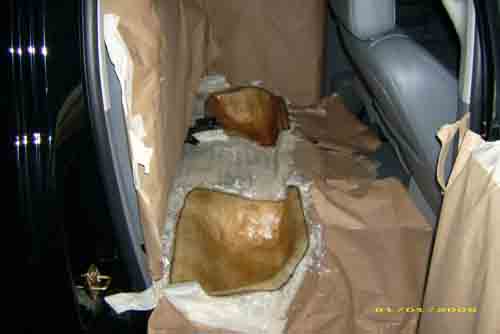

masking tape is applied to carpet so that I can apply resin and extract the mold of the space. Note In Most cases use of tin foil Is required to prevent damage from leakage. How ever I did not have enough Tin Foil or spray glue to attach the tin foil to the masking tape. so I just doubled up on the tape In a criss cross manner.

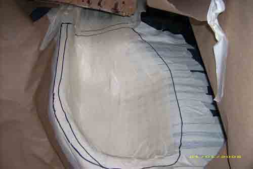

First Coat of resin and chop mat were applied to masking tape to extract mold. Note: everything is well protected from resin splatter and mess that could be created ps: Front seat were moved all the way up so I did not have to worry about them. (after this picture)

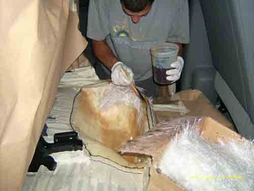

Both Sections have been resined up with about 3 layers of chop mat each. to speed up drying process and cut down on the prolonged fiberglass smell I turn the heat on in the car.

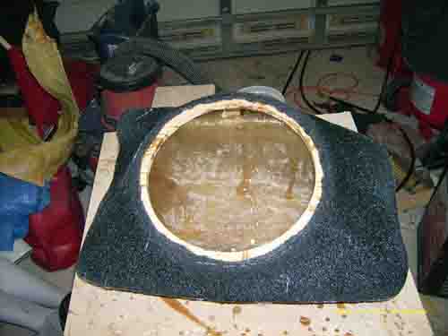

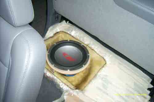

After Speaker Ring was fitted and angle matched to each other I stretched a non backing speaker box carpet material over the ring so that I can apply my resin. Note: I always use a fleese material however the location I get my supplies From were closed so I used what I had. which worked fine. The Material was stretched and stapled to the ring using an upolstry staple gun than spray glued to the side/ back of box. I Knew I was not going to apply resin to back of box so that is why I used spray adhesive to apply carpet to the box instead of staples. Plus just in case resin seeped through the carpet to that area, to prevent carpet from comming up I used a fiberglass layup Adhesive which will stay adhered more than a standard adhesive when met with resin. (Resin Deactivates Most adhesive Properties on Normal Adhesives).
06 dodge 1500 fiberglass project -- posted image.
Resin is Cured. The Hole is cut out of the ring. one further light coat of resin and chop mat has been applied to all areas inside the boxes where the carpet has been wrapped over the fiberglass mold. Than I sanded Down the excess off the back of the box and the top of the ring so that the box and speaker will sit properly. As intended.

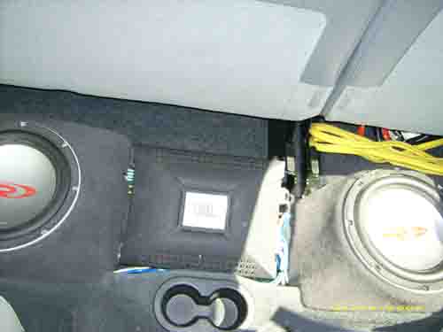

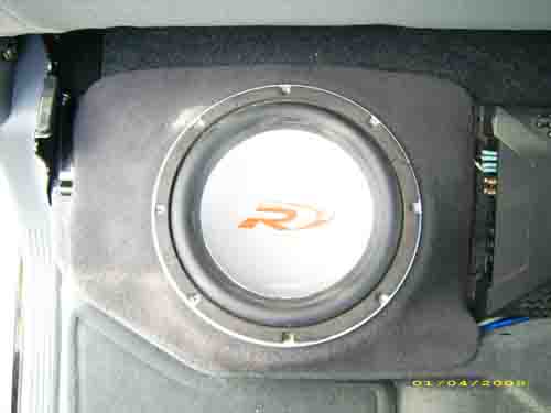

Both pods were carpeted to a color that matches the door pannels and is slightly different than the actual floor carpet. In a day or so I will be glassing a pannel to cover the amp just showing the heatsink and jbl symbol.

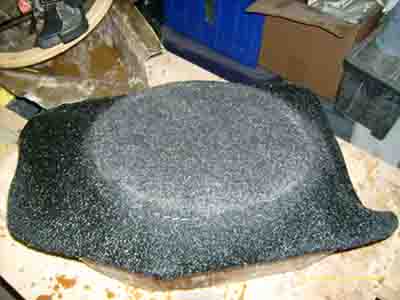

Passanger side pod upclose.

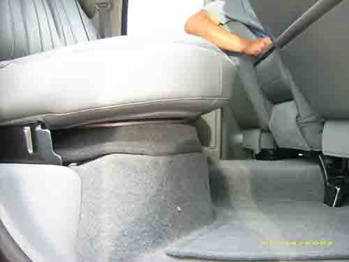

the way the pods both look with the seat in the closed possition. The actual seat even though there is material close to the speaker, from the bottom of seat cushion to the top of speaker is approx 2.5 inches of room. so the speaker actually has plenty of room. the material is flexible. The Speakers pods have also been filled with cotton filler. To enhance sound and seem larger to the sub. both pods are in specified sealed range from manufacturer.
