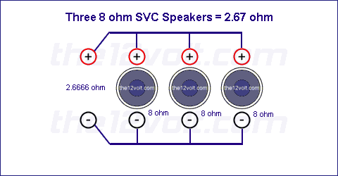

This is about as close as you are going to get with a 3 sub setup.So either dual 4 ohm subs wired in a series / parallel circuit or 3 8 ohm subs wired in a parallel circuit.
Option 1 (parallel) = 2.67 ohm load
Speakers wired in parallel
Recommended Amplifier: Stable at 2 or 1 ohm mono

What is "supposed to be a 1 ohm load"?  Your amp?  No, an amplifier's rating is for the minimum load it can safely handle, not a requirement of some sort.  If you are referring to the graphic forbidden posted, it is correct.
