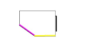

You want to build your box so that the port and driver both fire into the same airspace.  If you can design it so that it can be repositioned one way or another, that's a benefit.  You'll be able to pick the placement that sounds best from the driver's seat.  Some sub/box/car combos even sound best with the face of the box slightly uptilted.
Here's an idea on box design that would allow you to anchor it into a tilt position if that works out best.  And if it sounds better firing straight out, that also can be done:
best enclosure positioning for a sedan -- posted image.
PS Answers to the two questions:  No, and no.
