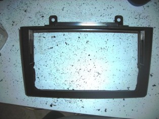

Well, I got the screen and duramix so I'm ready to go.  This is a picture of the scoche dash kit after I cut out the center to make it a double din.  I'm going to start filling in with duramix.  More pics to come...
Thanks for everyone's help!!!

Well, I ended up buying Duramix 4040 and 4058 and created my own dispenser gun by using a caulk gun and wood dowels.  I was able to use the 4040 to build up the major parts, but wasn't aware that i'd use one mixing per application and I made a horrible mess with it.  So I ended up using the 4058 for the rest of it.  I'm now finishing my sanding and will attempt a test install this weekend.  I will post pictures of my creation later today.
