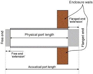

As for flaring the opening:  as it looks now the opening is squared and looks a little rough.  Putting a nice roundover edge on it will smooth port turbulence and lend a more professional touch to it.  Fb won't be affected.  But 2.5" is a bit close to the back wall, IMO.  There is an amount of airspace needed at each end of the port that actually functions as part of the acoustic port length.  The general rule of thumb is to leave the equivalent of the port diameter (when talking about a round port) to be sure you've allowed for ample space for true port function.  Since the equivalent round port diameter is much wider than the narrowest width of your slotted port...it would be in the neighborhood of 5 or 6" I would guess...I suggested a bare minimum of 3 or 4".  I would design it to leave 5 or 6", and that would be determined by finding the equivalent round port diameter first.

stevdart
Platinum - Posts: 5,816
Joined: January 24, 2004
Posted: June 28, 2006 at 10:28 PM / IP Logged
Ok, subs are already wired properly then.  And yep, a port is a port.  Here's an illustration of the acoustic port length vs. the actual physical port length:
enclosure design/vibration issues - Page 2 -- posted image.
I don't know any math to calculate the actual space needed, so I just use the rule of thumb I mentioned.  What you have may be enough and it's not something in itself to have to build a new box to change.
