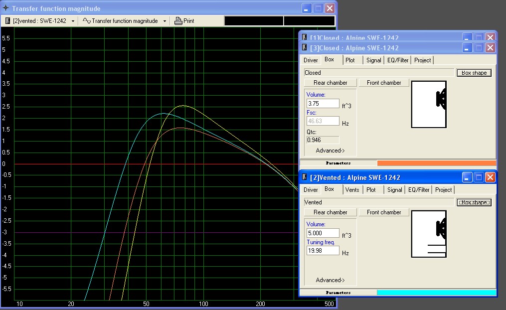

Here is a look at responses for this sub in WinISD.  I had already had this driver loaded in the database so it was a simple matter of just opening it up and trying a few different things with it.  Open the file, expand it to full size, and refer to the colored response lines that I will describe to you:
Yellow:  this is what you have now.  2 cu ft sealed, F3 is at 43 Hz (follow the line as it crosses the -3 db purple line).
Orange:  this is what I would recommend you change the box to.  It is also sealed but the box airspace is almost twice as large at 3.75 cubic feet.  You see that the peak doesn't go as high and that the F3 is pushed a little lower to about 38 Hz.  Would work well with any type of music and is a better SQ curve.
Teal:  this is what you could do by venting a box for these subs.  5 cu ft of airspace after deducting all displacements (such as port and drivers, and the added braces you will have to use).  The response goes up a little peakier than the orange curve but not as bad as what you currently have.  The F3 goes lower than either of the sealed types, to 30 Hz, which corresponds to the Fs of the driver.  The port is a PVC tube that has a 4" interior diameter and is cut to 14" in length.  This makes the box tuning at 20 Hz.
Now, because the tuning is so low, there will be very little sound emanating from the port structure.  You don't need to build the larger slotted port design (with its inherent larger displacement costs) because port noise will generally not be an issue at this low frequency.  And, tuning to a higher Fb by using a shorter port would result in a bad response curve....it would cause an abnormal peakiness to the sound.  Also, changing the box size to anything less than 5 cubic feet would give you an abnormally bad response.
Bottom line:  I suggest you rebuild your box as I defined above to the larger 3.75 cu ft sealed.  If you want to experiment with vented, and have the necessary space to do so, use what I showed here and nothing smaller.

thats so much more indf othen i needed. thats why i love this site. thanks a million for your time. i will make a bigger sealed box this time and im sure it will sound exactly how i want it to ..fro mthe chart it will be perfect..

just to update this post.. i made a sealed box with 1.75 ft of airspace per speaker... its like a brand new system. i made the first box as alpine wanted at 1 ft per sub..  NO WAY.. this is so much stronger.
