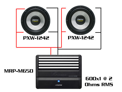

lol. Well after some research and math and such, I am wondering is the appropriate way to wire up my system? The subs are wired in parallel to show a 2 ohm load and each is then connected to the appropriate terminal, so will each sub see 300w of the amps power?
Why buy lots of watts? -- posted image.
Thanks again.
