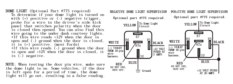

Also, i dont think i can hook my dome light input to the door pins circuit which is negative ground style i believe on the chevy blazer, because i looked inside the brain and the circuit that is labeled dome is burnt up,,, happened today when i installed the alarm and i smelt and saw smoke and unplugged it right away... hopefully the alarm is still good, the circuit s just burnt it may still be ok....though the alarm manual itself states that you can hook the dome to either a positive or negative door pin system... confusing... now what do i do with the dome?

1994 Chevy blazer door locks -- posted image.
