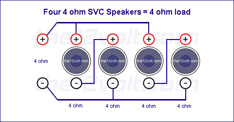

Now if you install those 8's in series parallel the amp will still put out the 300 watts rms bridged
Sorry series parallel?
Turbos and superchargers are like steroids in the big leagues, Seriously you need that?
aznboi3644
Gold - Posts: 2,600
Joined: May 01, 2006
Posted: July 08, 2006 at 9:07 PM / IP Logged
Yes those 8's will show a 4 ohm final load if they all are single 4 ohm coils.
Doubling wattage -- posted image.
Are you really thinking about purchasing four 8 inch P2's though?? I wouldn't recommend that at all...With your current subs you can have a new enclosure built that will rock pretty hard and sound cleaner than the enclosure you have then in now.
