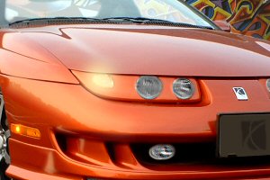

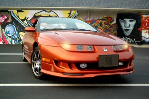

satfrk32
Copper - Posts: 61
Joined: June 11, 2004
Posted: August 08, 2006 at 12:41 PM / IP Logged
custom headlight covers -- posted image.
Got the headlights done, just wanted to show the final product to you guys. Appreciate the help!
cheers!
Melted Fabric
Silver - Posts: 509
Joined: October 24, 2003
Posted: August 08, 2006 at 3:11 PM / IP Logged
Nice results. That is a Saturn? Looks more aggressive. Good work guy.
