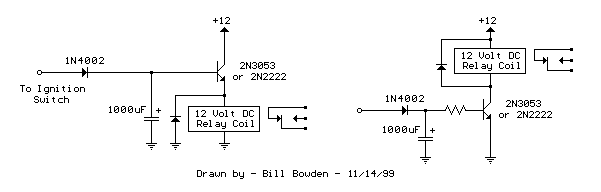

What you are looking for is a Delayed off timer that is triggered when power is removed.
You could use the Low-Tech approach.
555 Timer Problems -- posted image. Right?

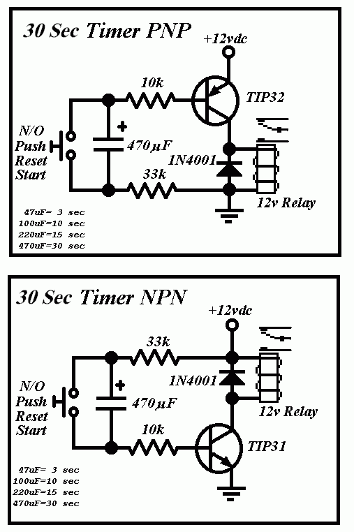

Here is one that I made.555 Timer Problems -- posted image.
