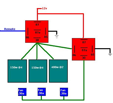

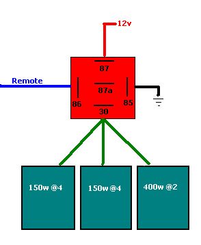

I know i can use a SPDT relay for the amps. but i also intend on using fans.  should i use a seperate relay for the fans?  and how should i wire both relays to the remote wire from the head unit?
Multiple Amp Relays -- posted image. for the amps?
Multiple Amp Relays -- posted image.for the amps and fans?
400/12.6 = 31.75amps
150/12.6 = 11.90amps
now should i put the 400w amp on a seperate 40amp SPDT relay from the others?
im unsure how to determine how much power is coming from the head unit.

If I interupt your diagram correctly, you intend to use a relay to provide power to three amps. Wrong. Use one relay and hook terminal #86 of it to the trigger/remote wire from your radio. Terminal #85 to ground. Terminal #87 to a fused (5 amp) source of battery power. Terminal #30 to each amps trigger/remote wire. You can also use this to power fans. Add up the current requirements of all fans, add 1 and use this value for your fuse on the relay supply wire. If your diagram is correct and each amp only requires 0.3 amps to work, then a 5 amp fuse is fine to use. Each amp must use a heavy gauge power wire fed from the vehicle battery. For most multi-amp set-ups, it is advisable to run a fused heavy wire off the battery (4 gauge) to the amps. Use a fused distribution block at the amps location, to split the cable into 3 smaller (8 gauge) wires to supply each amp with power. Use the same gauge wire to ground each amp. Install a fuse/breaker equal to the sum of the three amps current requirements within 18 inches of the battery. Each fuse at the distribution block should match the amps current rating requirements as ditacted by the manual for the amp.

yeah i got the power right.  just wasnt sure about how much power the amps use through the remote wire; or how much power goes through the remote wire.  thanks.

oh also, my dist block has 4 outputs, can i use the 4th output as the 12v source?

If I interpret your second pic correctly, It should work. If the 3 wires coming from the relay and going to the amps are for the remote turn on only, then yes, that is correctly.

As much power goes through the remote wire as is demanded by the loads.  Since remote wire is usually 20 gauge, you know there isn't a lot of amperage expected.

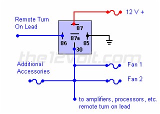

The amps will use less than 200 milliamps each (.2 amps).  Add up the amperage ratings of the fans and add them all up.  The output of the block would be fine as the 12 volt source.  Here is a diagram that the12volt has provided on this site:
