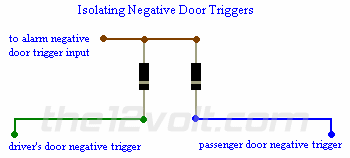

two sensors, one input
the12volt
Administrator - Posts: 3,959
Joined: March 07, 2002
Posted: August 03, 2006 at 12:25 PM / IP Logged
Diode isolate them as you would with multiple door triggers to one input.
two sensors, one input -- posted image.
two sensors, one input -- posted image. the12volt • Support the12volt.com
