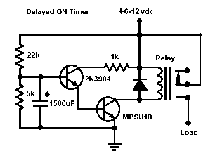

When you take power off of the coil this magnetic field collapses and causes a voltage spike in the wires in a reverse polarity from the original.
A clamping Diode will give this spike a path to ground. A Diode is like a check valve that lets voltage flow in only one direction.
Here is an example on Diode used to protect Transistors
Solenoid blows LED -- posted image.

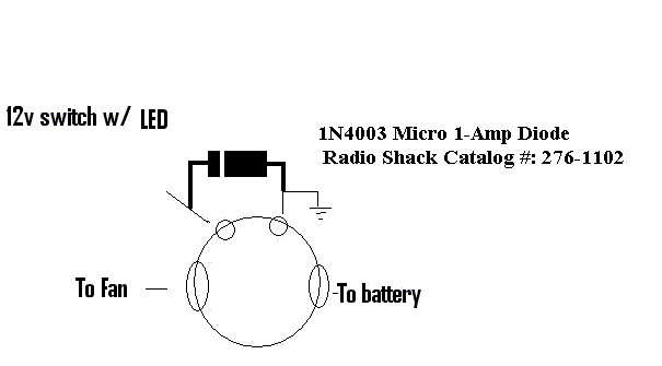

Thank you so much for the advice - I was planning on using a relay which would have just ruined another expensive LED. I'm more or less electrically incompetent, so you can you walk me through which diode to get, which way to wire it,etc. The solenoid I have is basically a starter solenoid with 4 posts. Main Power in, Main Power out, switch in, and ground. I've never used a diode before, so can you spoonfeed me or draw a diagram or something? Do I get it at radio shock, solder it on, etc? Thank you so much for the help. This has been driving me crazy for days..
