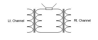

You could try a transformer type of coupling... It will be mono, but, it will also contain both right and left information, and the balance should continue to work, with information coming out wherever the balance is.
Try to get AIR CORE TRANSFORMERS! Iron core will soak up ALL your highs, even though air-core will still soak up a good portion of them.
Center Speaker Tweeter? -- posted image.
I can't promise this'll work, but it's as close as you'll be able to get, I think...

Well your never going to believe this. I simply hooked it up to both the front and right. Figuring it would make my front channels go mono. (When balanced left all fronts on and dido for right.) It didnt. Balance still works and the tweeter is on at all times!
I cant understand it. I mean, HOW? I can here a little bit in the left if balanced right but not enough to notice from a normal listening position. Its so wierd. But it sounds good. The highs are crisp and clear now. The 6X9's (even though 5 way) just didnt really make it the way I liked it. I may still try a transformer and later probably will get a 4 channel amp thats bridgable into 2 & 3 channel modes. I wouldnt mind having one and then get a 2 channel for the rear speakers.
Anyways for now I'm fixed. I just never tried this because I just knew it would make the fronts go mono and I didnt want that. Things like this fascinate me sometimes. You just know it will do something but NO. Why should it let me be right. If it worked that way all the time life would just be too easy.
Thanks for the info. I'll keep the transformer in mind for other projects.

Actually, it used to be a fairly common technique in the pre-surround sound days to add a third speaker to a home stereo amp, connected between the left and right + speaker terminals.  This "center" speaker would then reproduce the difference between the two sides of the stereo signal and "fill the hole" in the center of the soundstage.  It is NOT the same as having a genuine center channel, and it places a lowered impedance on the amp, but as long as the amp can handle the load it's OK to do.  I highly recommend you add a high-pass crossover to that tweeter to protect it or it will burn our quickly.  If you do want a genuine center channel, there are processors available that will generate a discrete signal for you.
