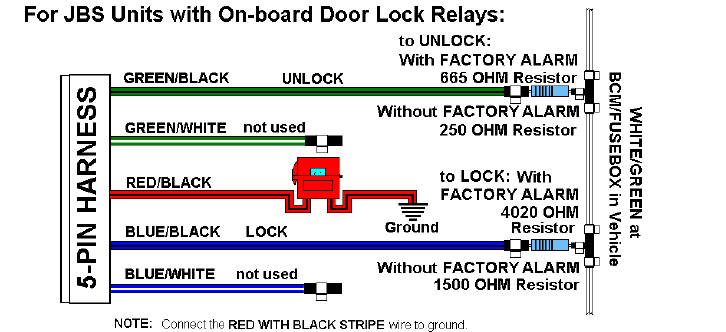

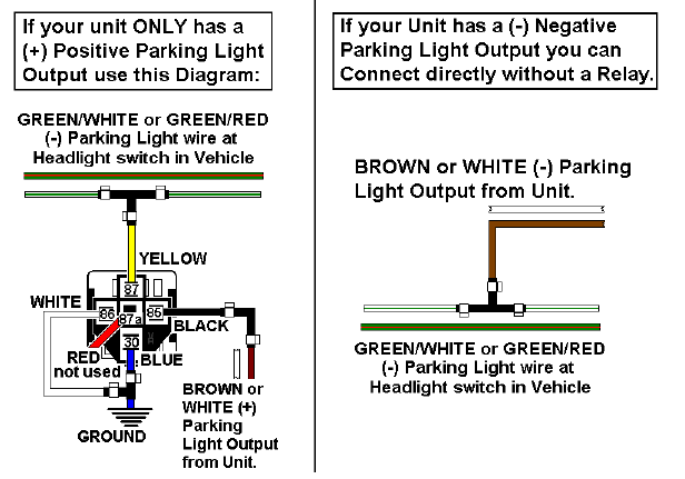

I installed a Bulldog Rs114 remote starter on my 1997 Voyager.The starter part works great but i have no flashing parkers and i cannot get the door locks to work.I have read that i have to use to resistors (1.5K and a 250 resistor)on the WHITE/ green wire on the left plug under the fuse box.The question is do i split the WHITE/ green wire and put the restors on each wire or do i just put the resitors inline?Does it matter which WHITE/ green wire(Light green or dark green).Also the flashing parkers should i take the brown wire and tie it to the positive wire up front to the parker light on the drivers side?Also i dont think i have keyless entry as i got no fobs when i bought it and was told since i have key locks on the sliding doors that it did not come with keyless entry.Thanks

Find the parking light relay under the hood....have someone flick the parking light on/off...you'll here it clicking. Pull the relay and solder you POS parking light wire from the R/S to pin 87. You nee to do a REAL clean solder job....so you can put it back in the spot from where it came.
Bulldog RS114 on 97 Voyager -- posted image.
It's the 5th relay from the main power feed to the relay box, on the fender side....

Thanks guys works great...Radioshack had no 250ohm resistors but 220 ohm worked great
