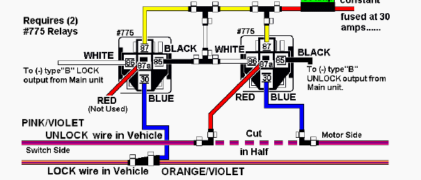

heres the situation. i have a customer with an 01 dodge ram pickup that we installed a dei 554t, im having issues with the doorlocks not working after the vehicle sits for a half hour or so, i grabbed the positive trigger locks at the central timer module to the right side of the steering column, lock is ORANGE / green, unlock is pink/green. anyone else ever run into this kind of problem on this vehicle? i already swapped out the DEI brain with a new one and no luck.

you have to do the locks 5 wire

01 dodge ram doorlock problems -- posted image.IN DRIVERS DOOR HARNESS, See DIAGRAM
