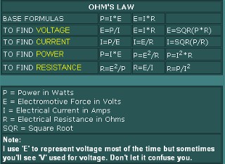

No problem as long as you set everything up carefully.  Go through the steps of setting gains all over again when you switch amps.  Here is a link to a thread where I linked some other individual threads; you should find test tones and other sources of info and help.
https://www.the12volt.com/installbay/forum_posts.asp?tid=75001&PN=1
What I'd do in this situation:  after setting gains by listening for clipping, test the voltage output at the speaker output terminals.  Back the gains down if necessary to match output voltage to the desired RMS of the speakers (use Ohms's Law to find voltage).

I believe that's where stevdart's graph was from. Anyway, you'll be able to learn quite a bit there that will be helpful in pulling your system together.
Also, don't worry about blowing the speakers. The real cause of a blown speaker is rarely an amplifier, but is rather the numbskull opperating the volume control. Put an appropriate high pass filters on those focals, set your gain with a brain, and operate your volume control with a brain. If you do this, you'll never blow those speakers.
Indeed, follow those three basic rules and no one should ever blow -any- speaker; not with a 3 watt amplifier, not with a 1,000 watt amplifier.
