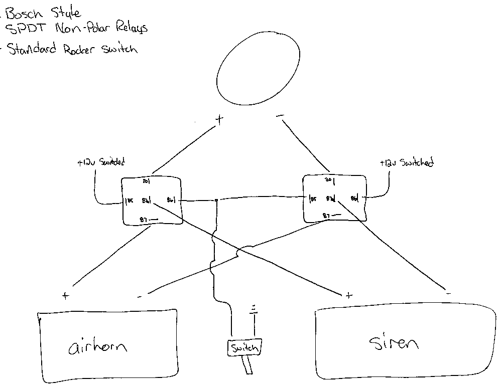

I've got 2 boxes, ones an airhorn/pa and the other is a siren, and they both need their own 100w speaker. But I dont feel like paying $100+ for a new speaker. I was wondering if someone can tell me how to wire a relay so both boxes can use one speaker. Both have positive and negative wires which go to the speakers and last time I wired all 4 wires to the speaker they came out sounding a lot quieter than they should be.

This is actually a fairly simple problem. You will want to use two relays or a 451m style relay. here's a diagram:Diagram needed on switchin inputs/outputs -- posted image.
It's Easier and more space effiecient if you can get your hands on a 451m
