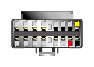

Then you use the mini iso (the yellow 6-pin called C1 in the figure below
or a red 20-pin or a black 20-pin)
'97 Audi A4 Gamma stereo replace -- posted image.
See the figure to make it easier to understand (the back of your Gamma headunit).
In the yellow connector:
Pin 1: Line out left rear
Pin 2: Line out right rear
Pin 3: Line out ground (common for all 4 channels)
Pin 4: Line out left front
Pin 5: Line out right front
Pin 6: Remote (common for all 4 individual speaker amps, not always used, sometimes
you use A3, equals pin 3 in the black 8-pin connector)
There should be a sticker on the Gamma headunit that explains all this to you.

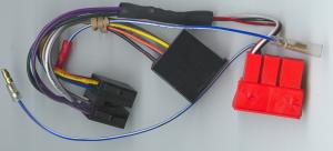

You could use this one:
This is Autoleads PC 9401 that fits several Audis.
There can be several to choose from depending on several things for example the voltage on the line out.
See http://www.autoleads.co.uk/installation_db.html for more info.
And if you dont want to cut any cables in your car you can look for an PC 3433 from the same
manufacturer. It will fit your Sony in one end and it has a female ISO in the other!
