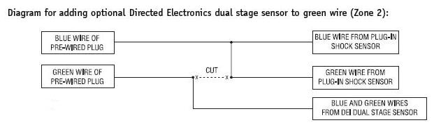

What alarm do you have? anyways
Blue from the asain wolf is full trigger (longer than .8)
Green is warn away (shorter than .8)
Most alarm are like DEI where you can do this:
dual microwave sensor? -- posted image.
Do not use the 12v and ground from the shock sensor! (the asianwolf must have its own)

If your alarm does not have the dual stage (warn away and full trigger) then you do not need the warn away wire.
If your alarm has an instant trigger wire, you can also hook up your sensor to that. But it will not have the dual stage
