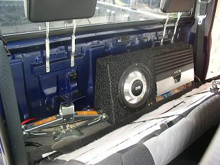

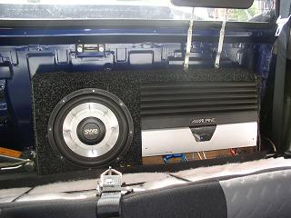

Head units I have installed before, however it has been like 15 years since I did an amp and had never built a Sub box until now

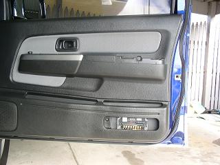

I have installed the splits in the front doors in the coxal option for ease of install, after making spacers to fit from the stock 6", I moulded one of the map pockets in the door to fit the x-overs. ( not the most conventional but I'm happy with the outcome.
For anyone who read my first topic " Advice for a newbie" you would be aware of the small space problem I had for a sub and the various options I had looked at.

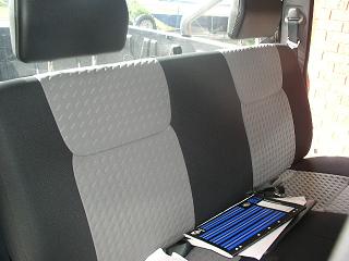

The sub box and amp rack was a huge issue, after much brain storming and cardboard mock ups( and my brain still hurts)
here is the end result, a custom built box to hold the sub and Amp, while still fitting behind the rear seat.

I must say that I was very sceptical about putting a shallow mount sub in after reading all the rants and not many raves. I had listened to many different options for a bass solution, including a couple of shallow mounts ( Pioneer sounded tinny) and was even more confused, until someone I knew said that the earthquake was a good option. Flying blind I took a punt and brought it with out hearing it. The punt paid off in my opinion.
It is a hell of a lot better than I had expected it to be after reading the reviews. I wont proclaim that it is as good as a full size 10", however in my opinion it is damm close and I would recommend to anyone looking for a solution like I was
