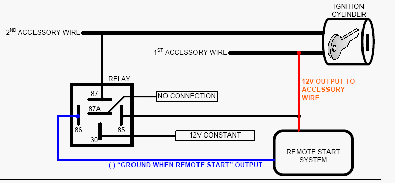

So, I've nearly completed the install of my Nustart remote starter. I did this originally in January but had to leave some of it until summer, because, well, my fingers froze.
The pathfinder has 2 starter wires, which I connected both to the remote starter, and 2 accessory wires, of which I can only connect 1 to the remote start.
So here's the issue: the car starts fine, and the doorlocks and everything else works fine, but the climate controls don't start, so the engine warms up but the interior don't.
I can't send a 2nd accessory out from the remote starter, because that wire is selectable and runs the 2nd starter for the nissan.
So, the question is... how to get the A/C to work with what I've got. Suggestions?

01 Nissan pathfinderLE remote start issue -- posted image.

Does the radio work with the remote starter on?
You don't need to power up the radio-accessory wire on that car.......that's the WHITE/ blue wire. Personally, I prefer to keep my radio off during remote start anyway.
So, all you have to do is, remove the wire you've connected to the blue/white......tape off the blue/white and forget about it........and connect your wire to the OTHER accessory wire in the car.
Done.
