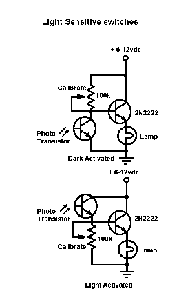

wiring up light sensor to relay -- posted image.
