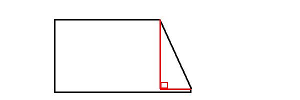

If the angled baffle is deterring you from trying to build this box, here's a tip on figuring out how to find the slant side length and the angle cuts:
Working your design out on paper, draw a right triangle where the slanted baffle is the hypotenuse.
18 inch solox sub box -- posted image.
Use this calculator:  http://www.1728.com/pythgorn.htm
The straight sides of the right triangle are sides 1 and 2; the angled side is the hypotenuse.  The calculator will give you the length of the hypotenuse and the cut angles for that slanted side.
For calculating box volume, keep your diagram broken down in this way.  All of the box volume except for that triangle is calculated as straightforward W X L X H volume, and the right triangle can be figured as W X L X H divided in half.
