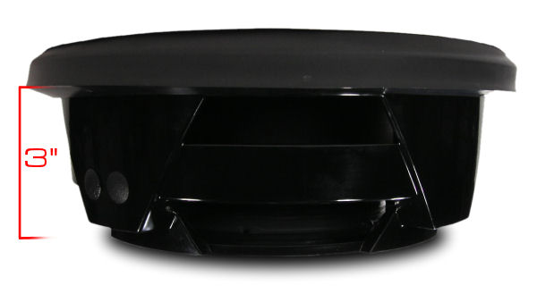

The  ultimate shallow mount driver. 15mm xmax..about the same as an Alpine Type R...except much more musical! I don't know what your budget is but TC Sounds makes this in a 10 and a 12.
PA or Kicker CVR 12 -- posted image.PA or Kicker CVR 12 -- posted image.

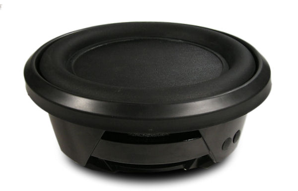

Here are the pictures of the power acoustik .... its almost the same as the tc ...what u think ? today i went and listened to some CVR's at circuit city and not what i expected but L5 10's sounded goodPA or Kicker CVR 12 -- posted image.

I compared the two subs and this is what I found:
PA: ceramic(standard material) magnet , TC neodymium(extremely powerful) magnet
PA: 2inch aluminium coil, TC 2inch aluminium or copper coil
PA:400rms 800peak, TC  350rms 800peak
PA: aluminium cone, TC  carbon fiber nomex piston(same as PPI proclass)
PA: 8mm xmax(one way), TC  15mm xmax(one way) almost twice the excursion
PA:  foam surround, TC rubber surround
PA: "jack of all trades" company, TC only builds subwoofers(20+ years of OEM manufacturing subs for Eclispe, MTX, Audiomobile, Digital Designs, Crystal Mobilesound, Soundsplinter,...)
PA: $110 roughly, TC $250 roughly
I'm all about SQ with authority, for me the choice is clear, TC has better materials, much larger displacement, and has audiophile sound quality. But it does come at a price $$$$
