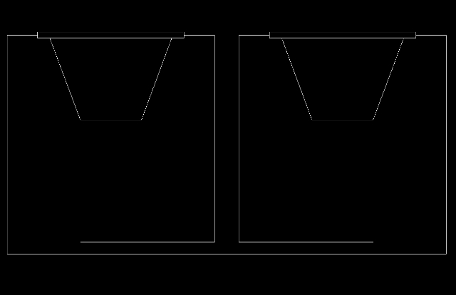

Well, does anyone know how to go about tuning with this type of port? How to account for the end correction factor, how to properly apply the length calculated since It cannot be done like a regular L-shaped port, since this is more like a T-shaped port?
L-shaped calculated like this for L1 and L2: building enclosure, port location? - Page 2 - Last Post -- posted image.
I'm assuming the T-shaped port would be L1, L2, and L3, but how do you go about taking the actual measurements of it?

The box is already divided into two chambers with that design.  Just put one thin piece of wood down the center to separate the ports and be done with it.  Each sub will have its own port and you'll be able to model without all the guessing.

I figured out how to design that type of port. beerman over at deCaf: Car Audio Forums helped me out with it.
