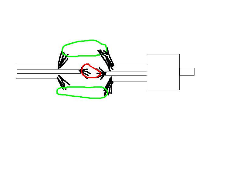

cut off the broken plug, strip the outter shield back like an inch or so.  strip back the inner shield like 1/2 inch.  do the same with another rca with a good plug on it < use the plug end though>  connect inner to inner, tape off, connect outter to outter, tape off---make sure inner and outer dont touch.  make sense?

rca plug repair -- posted image.

You can buy rca ends at radio shack. Just solder the inner conductor to the center pin of the rca and the shield/outer conductor to the outer pin of the rca.

I replaced the rca cables. The audiobaun were junk. The wires were so thin it was not worth repairing them. Took about 45 min to hour to replace them.
