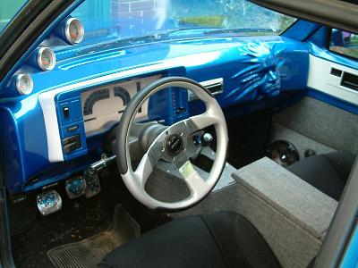

not sure if other post worked i am new to all this , anyhow as for face comming out of dash the end effect is the face looks like it is being pushed out of the dash ( i will try and find a picture ) and for sub box or link project can someone drop me a list of things i will need to be started and a few tips or along the way and i am sure canadian tire/walmart is good enough to get this stuff ? thanks alot in advanced

here is a pic of it in a truck or is there any easy way to do this kina thing on a 2001 sunfire ? new to fiberglassing -- posted image.

good luck, that is advanced for most people that know fiberglass well, i think you should start small, Just my 2Cents

Yeah, that is an advanced level of FG. That S10 looks familiar...
Start with the box and/or panel, then maybe consider possibly going on to the dash.
For the dash, your framing will be absolutely crucial along with your tolerances. (For dashes, you'll only have at most a 1/16" tolerance if you want it to look decent. Top installers try to work within 1/256" - 1/128" tolerance especially if they are going to paint with it. If you are going to go for skins (vinyl, suede, etc) you'll have more room for tolerances. 1/32" - 1/16" if you are looking to flush fit sections together. Make sure you take into account everything when planning (shrinkage, wood thickness, paint thickness, etc.)
Start with the box and panel. The key, again, will be your framing. The stronger and more secure it is, the less chance you'll have fitting issues.

definitely quite the undertaking.  Like everyone else said, start small and let the creativity and built-in know how that you seem to have show you what you can do.  I find that builds a lot of confidence in an installer just starting custom.  If you bite off more than you can chew you'll likely get very frustrated and lose confidence in yourself, this is bad.
