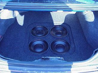

2 12's in Rear Deck -- posted image.
heres a pic of a 95 Chevy Beretta that i did a long time ago 4 memphis sw10's and i belive it was a 1000d amp on a floating mount. i remebered it was loud as hell thou
