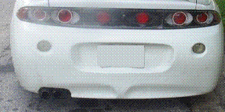

i was recently rear ended and am waiting for insurance money which i see as a good opportunity to learn how to do body work without killing my wallet.  i want to take my eclipse rear bumper and take out reverse lights move the license plate and probably shave the exoughst hole and put it somewhere else ... Bumper customizing -- posted image.
i planned to do it with fiberglass but will that hold right ... any suggestions (other than to buy a body kit ) i want it to be diff from anything else but im new to body work and i have heard fiberglass has trouble sticking to a bumper in the long run...

Bumpers are an advanced level of glassing. It is an area that is constantly exposed to the weather along with whatever you through at your car (rough roads, bumps, really sharp turns, unskilled drifting, etc) How much experience do you have with it?
You are going to have to make a jig for the bumper and build a lightweight but super strong frame that will take all the pressures of driving. Since it is the rear bumper, drag pressure (especially above 70) will be your biggest enemy for this. Plan on using struts where the bumper will hang off of or away from the car with no supports. It sounds/looks like you plan on modding a factory bumper. It's a urethane bumper so it will expand and contract more than FG will so blending it seamless will be kind of useless because the expanding and contracting of the two materials will crack the bonding areas. If the bumper you are using is FG then there shouldn't bee too much of a bonding issue if you hit the areas that you are bonding to with 40-60 grit sandpaper and then bond the pieces together and smooth it out.
If the bumper is urethane, your best bet for a clean and to minimize the maintanence is to create pieces that bolt or rivet on to the bumper and seal around the piece. Depending on how wild you want to get with the design of the bumper, you'll use different techniques.
On a safety/legal note: where do you plan on reloating the back-up lights? Unless this car is only going to be used in shows strictly, it is required in all states that backup lights are on the vehicle. How/where will the liscence plate be after modding?

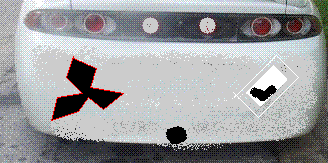

this is what new tail lights look like and the middle 2 are only reflective but i could rig a harness and drill hole out on them and run wire from old lights into it (i figure this will be easiest part of whole thing....  as for glassing the bumper and it flexing still wondering is tere anyway to avoid this and still have car as my daily driver because my car rattles alot from the 2 15" rockfords in the trunk so i figure even without bumps that bumper with alot of glass on it won't like me...   if i don't have a huge amount of layers would it be more flexible and then i could just use really good paint or would that be a bad idea?
this is one horrible photoshop of kind of what i am trying to achieve and i may paint tailights white or keep black haven't decided....

I see the general idea of what you are trying to acheive there. you want multiple layers of glass for strength, don't worry about losing your rear bumper on I-35 going 70 miles an hour. The glass will hold, but for added support, hit the bumper on the back with a light sanding of 40 grit paper, drill some holes (1/16th bit) about a quarter to half inch apart from each other and lay the glass over that. I do it alot of get fiberglass to adhere to plastic. If you plan on making that Mitsu symbol 3-d I would suggest a foam block sanded down to rough shape, wrap it in aluminum foil, use super glue of spray adhesive to attach it temporarily to the car, and glass over that. It will give you the shape but ALOT of sanding will go into that. As for your recessed license plate, I once did it to a Honda bumper, I cut out the shape of the license plate into the rear bumper (canted like you have it) and built an MDF lices plate housing with an MDF ring around it to set it in about 1/2 an inch. Then I glassed it from behind and laid glass down in front to seal it in there...once again ALOT of sanding but, you have to be sure that you cover up the MDF with fiberglass because if it gets wet it will split, then it will look like doodie. Too bad you don't have metal because welding is SOOO much easier.
