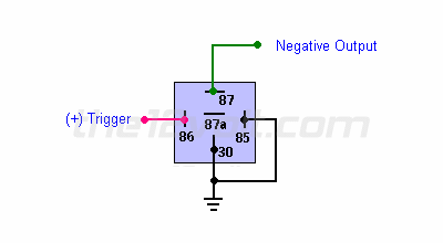

can anybody help me plz i have this alarm and i cant get the centrel locking working ? it runs of a single wire i think + to open and - to close my alarm has a + 12v output on both wires i need to make somekind of swith that turns to + then to - each time i press that button i dont have many fusses left so plz someone help thanks

vw polo 1998 alarm -- posted image.you need a SPDT relay
