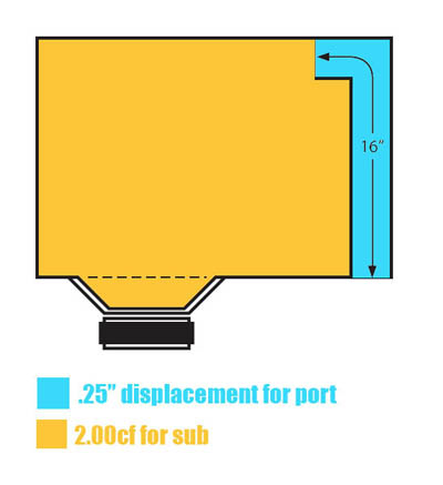

Ok I pluged those numbers in and came up with .231 the port displacment was set at .25 is this going to play with the sound of the sub at all being off by about .02? Sorry about the questions I just want to get this thing right.
So overall the space inside the box with the port should be damn close to 3888ci? Take the 3456 (2cf for the sub) and 432ci for the port and divide by 1728 to get an overall of 2.25cf.
Here is a box I drew up just to see if this is right. The orange area is the 2cf for the sub and the grey is the .25 for the port and is 16" long, did I get it?

When you are deriving box airspace, use only the airspace that is dedicated to the woofer, not the entire amount that includes ports and baffles.  Saying that it is 2.25 overall can cause confusion...if there is exactly 2 cu ft dedicated to the woofer then that is what you would say.  It would be a 2 cu ft box.

So as long as I have a 25sq" port that is 16" long be it round or sloted I am good? Did you see the box I drew up? Would that be the correct way to measure the port and the displacement for the sub?

Gross is the whole thing.  Net is the airspace that's left for the woofer after displacements have been deducted.  You can be reminded of this every time you pick up a jar of something from the grocery store...it will say on the label "nt wt" or "net weight", which will indicate the weight of the product in the jar...but not the jar itself.

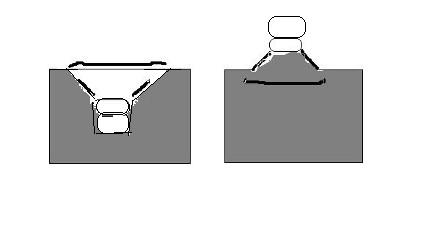

otto34, the drawing doesn't indicate how to measure.  But you are definitely on the right track, and this type of knowledge doesn't come quickly.  The drawing indicates, to me, that you are a pretty good drawer but not yet a box designer.  Arrange the port so that it fires out the same side as the woofer, even if you have to put an elbow in it.  If you want to invert the woofer as the pic illustrates, allow an additional approx. .03 cu ft for the area within the cone, which will be a part of the box volume.
I make much cruder illustrations, and here is an old one to prove it.  This shows that an inverted cone driver will add to the airspace in the box:
Ported box for a MMATS Dread 12 -- posted image.
There is always a little bit of guesswork involved in coming up with net airspace, and the ".25" in the spec sheet that we talked about proves the point that it is alright to be close.
For your port displacement, measure the port structure from the inside of the baffle to the end of the port, in length.  A 16" port that is mounted through a 3/4" baffle will actually measure 15 1/4" long.  Find the outer diameter, not the inner, for port structure measurement.  A 4" inside diameter might measure 4.25" on the outside.  This total volume is displacing air from the enclosure.
Oh, I just double-checked your question and, yes, round or slotted doesn't matter as long as the square inch opening is 25".  That's inside opening area.
