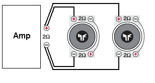

sorry if this is retorical, but is the monoblock class D amplifier only for one subwoofer? or can u get more subs hooked up to it. and if so how is that?

A mono-block class-D amp can be used for multiple subs.
It's important to get the impedence right though and match the amp to the subs (or vice-versa). This is a must for proper function.
here's an example...
mono block amp -- posted image.

im so stupid. ok what i mean to say is, i got a mtx 12 inch 9500 series and im about to get me an MTX 81001 about 1500 watts u think its safe to get another sub and hook it up like that?

wvsquirrel
Gold - Posts: 1,237
Joined: July 27, 2002
Posted: October 13, 2006 at 12:02 PM / IP Logged
Here's your specs if you have the DVC sub...
MTX T-9512
4ohm DVC rated 500RMS 1000Peak
MTX 81001
class-d mono-block amp
1ohm stable
500x1@4ohms
1000x1@2ohms
1500x1@1ohm
If you buy another T-9512 4ohm DVC then you can wire them together for a 1ohm total load. Each sub would receive apx 750watts (although I think the amp has overrated specs). Make sure you set the gains correctly and you should be ok.
