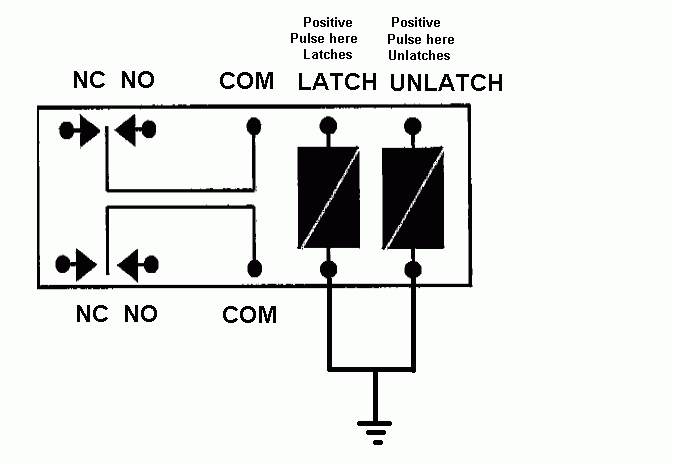

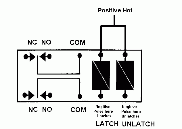

Hi, Guys
I have a shinmei latching relay....!????!!?
https://secure4.vivid-design.com.au/jaycar2005/products_uploaded/SY-4060.pdf
I can't figure out how to wire this up...
I have a a keyless entry system which puts out a negative pulse....
I want to be able to use it to turn my neons on and off....??!?!
Any ideas
Cheers

Latching relay issues -- posted image.

and be careful only 2 amp output. u will want a relay after the output...
