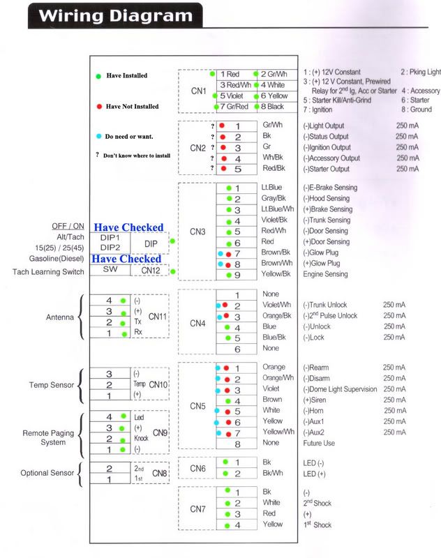

Below is a link to a scan of the wiring diagram of the alarm. Also I have marked which wires I have installed(Green dot) and the ones that I have not(red dot).
Wiring Diagram
Notes about Wiring Diagram
94 Acura Integra Wiring Diagram
Thats mostly it! I think I think the problem is mostly in the 2nd connector and its wiring!If there is any more info needed just ask! I tried to supply all the info I could! I think some of the wording in the directions threw me off but hopefully someone can show me the light!\

According to the manual, the RED / white wire in CN1 pin 3 has to be connected to 12 volts constant to provide power to the unit even if you do not use that relay. I would also check the hood pin and ebrake wiring to make sure they are functioning correctly. CN2 wiring is for 1)(-) parking lights, 2)a transponder and 3,4 and 5)to activate the relay for 2nd ignition, 2nd accessory or 2nd starter(which your car doesn't have).

Alright from bbtaco's reply I have installed the CN1 Pin 3 and still its not wanting to start up! Also your saying that I dont not need to install anything for the 2nd connector right?

You will need to hook up the clutch bypass. Connect the black status output wire at CN2 pin 2 to the clutch switch wire(I think it is blue/black on your car)this should allow your car to start using the rs.
