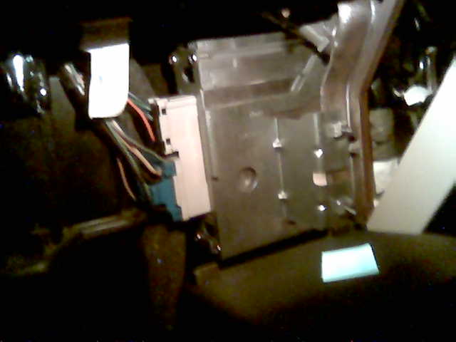

I haven't checked them out yet in the cargo area, I will do so in a couple of days. I did get bored and looked for a hidden amp somewhere and decided to look behind the glove box. I ended up taking a blurry photo of this:
Passing power cable through firewall - Page 2 -- posted image.
So, do you think that is the hidden amp that is helping power all these speakers?

Could be, looks like it has factory amp/speaker wiring to me.
Regardless, it does not look like anything critical such as SRS or any kind of control module so I would suggest this...
With the vehicle off, unplug one the harness plugs. Turn on the vehicle, turn on the stereo and see what is or isn't playing. If all is still playing turn key off and reconnect. If any speakers stop playing you found the hidden treasure. You can acess the speaker wires off that amp and run them to the dash or to the location where your aftermarket amp(s) will be installed.
Keep me posted. If it is an amp I will tell you how to determine what all the wires are.

Posted: October 30, 2006 at 1:27 AM / IP Logged
Ok, not only did I confirm that the device in the picture is the factory amp, I also found some information at http://www.metraonline.com/downloads/pdf/TurboWire/INST70-2056.pdf that told me the wiring of the factory amp. Now I need to decide if I need to bypass it...
