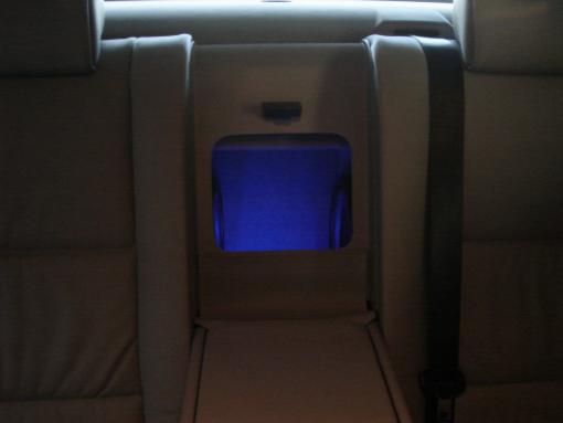

to all of you audio experts: do you think facing subs will give me good bass. i seen a BMW on the net that had this setup which looked real cool but i dont know if it would sound good. Subs facing each other. Good idea? -- posted image. i couldnt upload the second pic which showd it better but basically he has his subs each in a sealed enclosure facing each other and another sealed enclosure where they are facing each other. does anyone know if this would sound good

As long as they are out of phase of each other, there's no problems. Wire one subwoofer opposite on the terminals to the other and this will create one sub to act out of phase.

what will that do? it will be the push/pull effect correct. so if they are both in phase then it will sound horrible? the reason why i am asking is because i have two 12' kicker L7 right now and my trunk rattles like crazy so im trying to figure out a way to set it upto where most of the bass goes into the cabin. thanks for the reply

Wouldn't this just cancel out all the output? Why would he do it this way? I'd think 100% in-phase would be the way to go. School me please.
What are we looking at in that pic, an open hole or a plexiglass window?

i have put in sound deadner but it still rattles. i have a lexus gs300 so it alreay had some deadner in it.the picture is a plexiglass window but i was thinking of having it open to let the bass go thru the cabin. does anybody have any other ideas of creating a custom box so that all the bass goes to the cabin?

Deadener = you have to apply damping (Dynamat, etc.) directly to the sheet metal in a lot of areas when you double up on the subs, especially the trunk.  Even modest one-sub systems need a lot of metal damping done.
All the bass will go into the cabin and it will all go into the trunk...all you do is provide an opening from trunk to cabin.  The opening will allow for equalization of pressure throughout the car.  Build a standard, tried-and-proven sort of enclosure for your subs.  Face them to the same direction (try toward the rear of the trunk), as you should have plenty of room to work with in a Lexus.
