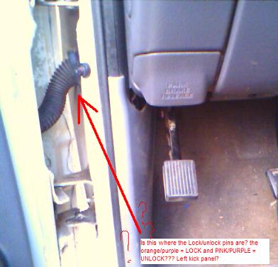

99 Dodge Ram 2500 lock/unlock pin locatio -- posted image.
Is this where the pins are at?

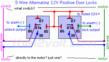

The wires you need are in that rubber boot, but you should be able to remove the panel beside the brake and find the harness where it comes into the car. Wire up two relays like the above diagram shows, 86 and 87 to 12volts, 85 from the lock outputs on the alarm. For lock, cut the orange purple wire and attach the end from the door(switch side) to 87a and the end away from the door(motor side) to 87. Now do the same for the unlock wire. Make sure you fuse the relays.

these wires are a pain to get at. if you take that cover off the kick panel, you will most likely pull out a black garbage bag looking thing with some foam in it to reveal the plugs with the doorlock wire in it. OR, you can just get the wires at the door boot.
So two relays is all I am going to need (for LOCK & UNLOCK)?
Diagram above shows 12v @ 87 and 85
30 goes to motor
87a to switch
86 alarm lock output
IS THAT RIGHT??
So the neg (-) output from alarm is correct for the contact 85?

Yes two relays, one for lock and one for unlock. 86 and 85 are interchangeable, so you can connect either to 12volts as long as the other is lock output.....
