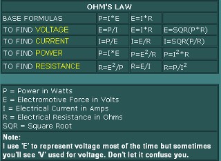

Looking at these numbers, now use Ohm's Law to find how that relates to amperage draw from the car's electrical resources.  Here's an Ohm's Law chart for reference.

To use Ohm's Law, if you have two known values you can find the third value.  You are considering power draw so you will use the system's resources as the known voltage.  With the engine running, voltage (E) can be considered to be 14.4 volts.  Power (P) is the demanded power we have found above.
I = P/E
I = 1000 watts / 14.4
I = 69 amps (current)
