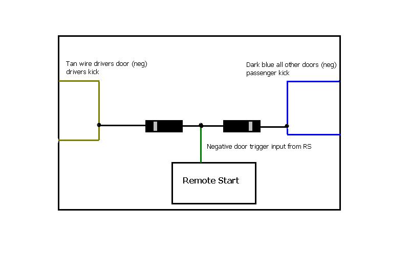

master5
Silver - Posts: 1,123
Joined: October 10, 2006
Posted: November 06, 2006 at 9:48 PM / IP Logged
Use this diagram once you found the right wires...
2000 grand prix R/S problems -- posted image.
