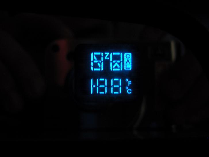

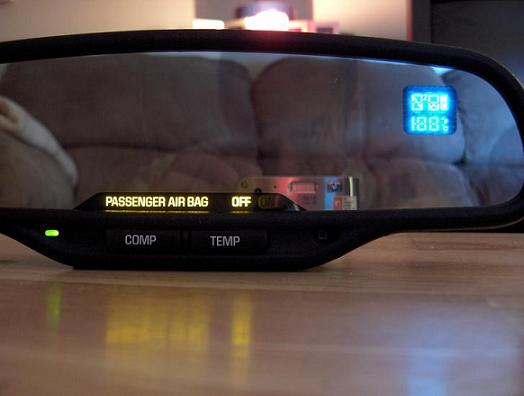

I recently worked to install on of the OEM version of Gentex mirrors in my vehicle.  When the unit was powered up, I found that the entire display would illuminate and never go to a normal display.  All other functions for programming, calibration, on / off seemed to still be working, but no matter what, every segment of the EFD stayed lit.  I stumbled on one other person who had the same problem, but unfortunately the trail never said whether the issue was fixed.  It implied that the problem was a lack of temperature probe connection in the final post.
After some frustration, I finally dug deeper into the system and found the root cause, at least in my situation.  The compass engine (remote module) connector had come out of its socket.  This likely caused the mirror to go into "error" mode and the indication was to turn the whole screen on.

The mirror consists of two electronic modules.  The main one is in the mirror housing and controls all of the mirror functions.  The second is a little PCB that is hidden beneath the black clam shell housing that is integrated into the windshield connection.  If you gently pop off the cover it will reveal the PCB which has a socket on-board and tiny mating connector.  Make sure this is fully mated (mine had pulled apart completely) and this compass module is properly oriented in the housing...orientation is important if you want the compass to work properly when you're done.  One you've reconnected this location, reassemble the housing to he mount be careful not to pinch the short supply harness.
I am posting so just in case there are more people out there that may run into the same thing you won't have to hunt quite as hard to find one definite fix.  One final note, when the temp sender is disconnected, the mirror will still work, but the temp display defaults to 0.  Hope it helps, good luck.
