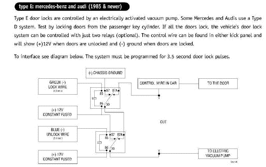

Hi all
Have read through most of the topics on this but all seem to point to using a two-relay setup which I'm not sure that I need.
Just purchased a Falcon Predator EVO4 alarm but not sure how to connect to the central locking, the installation manual has the following diagram
1989 Mercedes 190 Central Locking -- posted image.
Please could someone advise how to connect the merc wires to this ?
Thanks
Andy

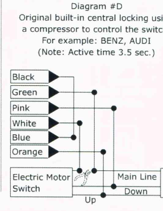

lsondubz
Copper - Posts: 193
Joined: September 20, 2005
Posted: November 11, 2006 at 3:22 PM / IP Logged
Power Lock blue or green L,R kick or pump under rear seat
