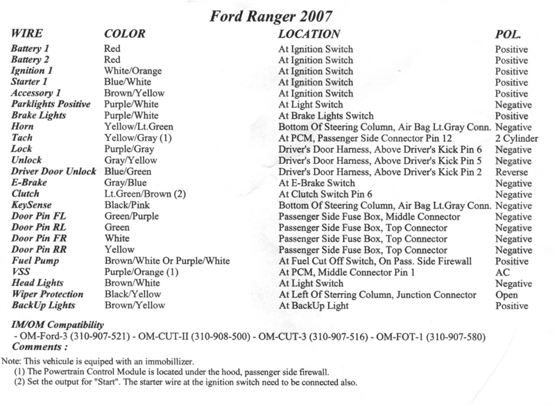

Update :
I now have a wire diagram for the 2007 ford ranger, my question now I want to use the park light or the head light wire but it seems to have a Negative polarity at the back of the headlight switch. how would I wire this to the relay I want to use to turn on the fog lights when I turn the headlight switch on.

use the Parklights positive wire (PURPLE / White) at the light switch as your trigger.
Wire up your relay like so
85 fused to parklight wire
86 ground
30 to fused constant 12v+
87 to switch
switch should be 2 prong or 3 prong depending on if lighted or not, connect other prong to your fog light trigger, if lighted switch one will be a ground, look at the directions for the switch.
Now you have the ability to have the lights on legally with the parklights, and if you dont want them on flick off the switch and they are off.
Hope this helps.

This worked out great thanks for the help mustangfoo. You rock !!!!
