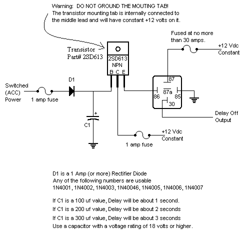

hotwaterwizard
Silver - Posts: 1,350
Joined: December 11, 2003
Posted: November 30, 2006 at 8:58 PM / IP Logged
I need relay to hang for an extra 2 sec -- posted image.
John DeRosa (Hotwaterwizard)

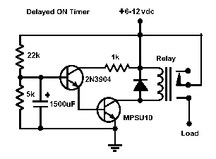

hotwaterwizard
Posted: November 30, 2006 at 9:03 PM / IP Logged

Ween
Platinum - Posts: 1,368
Joined: August 01, 2004
Posted: November 30, 2006 at 9:58 PM / IP Logged
hi,
isolate the phone kit mute wire from your relay with a diode, 1N4001 (band towards phone kit).  add capacitance across the coil of the relay.  the value you add depends upon the several factors (resistance of the coil, drop-out voltage).  if it's a bosch or equiv., i'd start with around 1000uF and adjust from there.  25 Volt rating should be fine.  the relay should remain energized for a brief period of time even after the mute lead goes high.
hope this helps
mark
