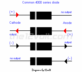

A diode STOPS both a NEG(-) signal and a POS(+) signal from going in a certain direction....depending on the placement of the diode.
What’s the Reason to Diode Isolate? -- posted image.

taking this diagram as correct, why is it that if you use an ohmmeter it shows continuity if I use the (+) of the ohmmeter to the (+) of the # 1 diagram and the (-) of the ohmmeter to the (-) of the diagram?  Is it because electricity travels (-) to (+)?
