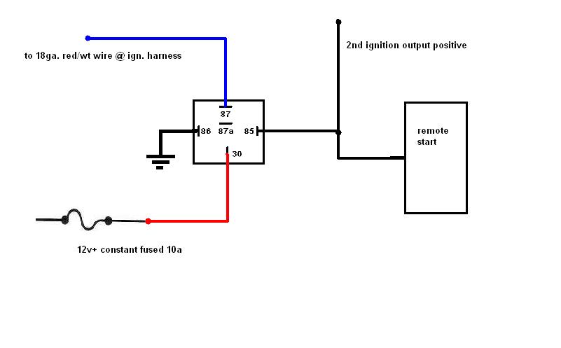

The SRS (air bag) warning light may come on after remote started, after the key is inserted and the remote start shut down with the brake. If this happens, find an 18ga (NOT 12ga) RED / white in the ignition harness. Power it as an Ign 3 with an additional relay.

if you require a diagram on how to do this let me know. The only info I will need is if your remote start as an output for 3rd ingnition..and if so is it negative. If not does it have a positive 2nd ignition output. If you already know how to do this then disregard the post.

it is a 1304 crimestopper and it has a 2nd ignition but that is connected to the box via the t-harnes.  I would need some wiring help with the relay if you have any info.  thanks

Ok..you will still keep the second ignition hooked up as it is...but tap off it to feed the relay...here is the diagram,,,,,
2002 chyrsler conorde with starter -- posted image.

could that be why it wont shut off when you turn the key off when started with the remote starter?

No..that wire only has to do with the airbag warning light.
The only thing that could cause the engine not to shut off with the key is if the brake shut down is not hooked up..or if you turn the key off before stepping on the brake if it is hooked up.
