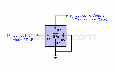

If a keyless entry unit has a relay built in to operate the parking light flash and shoots a positive charge, is it ok to use that output to run another relay to change the trigger polarity to negative or will that cause problems?

u can just diode isolate and it will have the same fuction as the parking lights, flashing then stays on...

In the diagram below, where would you put the diode?
